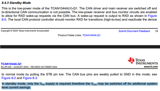

  • I have an additional question regarding this matter.
    The Vcc and Vio power rails are present, and the Low Power Receiver is said to operate on Vio power during Standby mode.
    Looking at the datasheet, the current consumption for Vcc in Standby mode is approximately 1.5µA, which is very low. However, Vio consumes around 8.5µA, which is relatively higher.
    Is this understanding correct?
    If so, is there any benefit in setting Vcc (+5V) to 0V during Standby mode?
    As long as +3.3V is supplied to Vio, should I assume that the device will consume at least 8.5µA of power?
    I appreciate your insights. Thank you.
  • Hi Takeshi,
    Yes, your understanding is correct similar to the below, thanks.
    Michael.
  • Thank you Michael,
    I have reviewed the contents of the specification sheet. I did not fully understand the parts marked with a marker. It states that in low power mode, it operates solely on Vio, allowing the Vcc connected "other devices" to reduce power consumption by setting it to 0V. This means it does not claim that the power consumption of TCAN1044AV itself is reduced, correct?
    Takeshi
  • Hi Takeshi,
    It is applicable to both, I.e., when Vcc is off, the device level current is reduced. Hence, overall system level current is also reduced, thanks.
    Michael.
