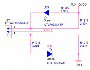

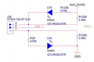

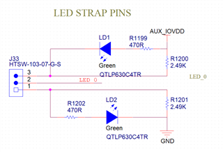

    Additionally, could you clarify the correct LED strap settings for 1000BASE-T to 1000BASE-X with Auto-Negotiation and Auto MDIX?
    Sivam Natesan
    These are the correct straps to place DUT into 1G Media Converter Mode.
    For LED straps, LED1 and 2 are negligible since they only control CU advertisement. So long as the CU link partner is also advertising 1G, this shouldn't be an issue. However, as best practice, you may set these both as PU.
    Sincerely,
    Gerome
