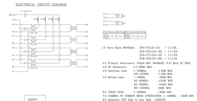

Can we used RJ45 connector with integrated magnetics part number 3-2301994-5 from TE connectivity with PHY DP83867IR ? Based on the datasheet, "Each center tap on the side connected to the PHY, must be isolated from one another and connected to ground via a decoupling capacitor (0.1 μF recommended)",  but here it is shorted and connected to P1. Please guide us.
  • Hi Salini,
    Because the center tap of separate channels are shorted together, we do not recommend this connector.
    We recommend Pulse Electronics HX5008FNL for a discrete magnetics component.
