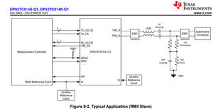

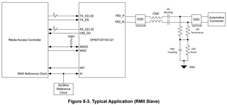

Hi-
I'm a bit confused by XI in this connection diagram. I believe XI should take a 50 MHz clock based on the wording in the pin descriptions. However, both a 50 MHz clock and 25 MHz clock are shown on XI in this image.
1. Should I attach a 25MHz or 50MHz clock to XI?
2. Can you confirm that XI is the correct pin to attach to the RMII interface?
Thanks so much.
