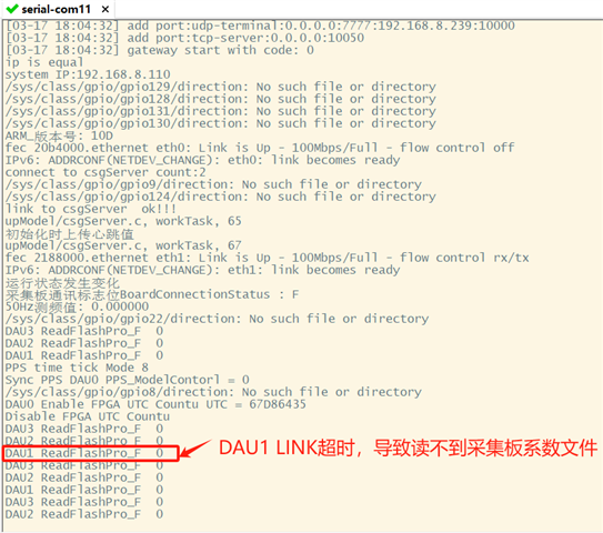

When using PHY chip DP83640 to power on, we may encounter a long LINK delay of the network port. PHY chip DP83640 on the acquisition board is not connected to the main control board in time for more than 3 seconds (Note: it can be linked eventually), resulting in the problem that the entire system cannot read the coefficient file of the acquisition board.

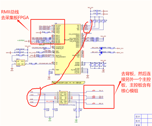

Here is our schematic diagram
Note: ETH_RMII_CRS_DV, ETH_MDC, and ETH_MDIO all have no signals when they are powered on, and no signal is sent from the core board to the PHY chip. That is, the PHY chip needs to be configured automatically without the need for the core board to configure it.
The serial port displays the following information: When the board DAU1 LINK is powered on, you can see that the faulty board DAU1 Link times out, and the board coefficient file cannot be read.

    What PHY is on the acquisition board, is it another DP83640?
    I noticed in your schematic that you have the TPTDP/M shorted to TPRDP/M, can you please remove the short and see it improves the link up timing?

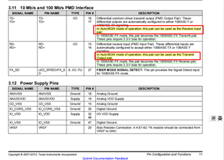

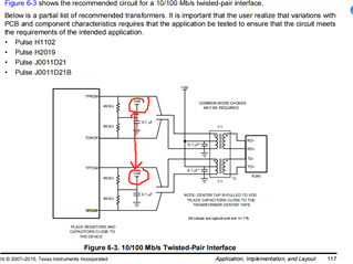

    I checked the datasheet  of  DP83640 on Page 117, all the 4 nets of TPTDP/M and TPRDP/M, how can I remove the short?
  • all the 4 nets of TPTDP/M and TPRDP/M are shorted to VDD.
    I apologize for the confusion.
    Could you change C258 and C259, which is the center tap of the magnetics to 0.1uF? According to your schematic, those are currently 2.2uF. Our recommendation is 0.1uF.

    I tried  change C258 and  C259 from 2.2uF to 0.1uF, the acquisition board was not connected to the main control board in time, No improvement has been made.
    But I removed the pull up resistors R140,R141,R142,R143, closed to PHY CHIP, the issue we encountered is solved .
    Is any risk if I removed the high up resistors R140,R141,R142,R143? The datasheet of DP83640 on Pagef 11 ,  the pull up resistors are not  a mandatory requirement.
  • One more question, if I adjust the value of the pull up resistors R140,R141,R142,R143 from 51ohm to 20ohm, is there any risks ?
    Just now  I removed all the pull up resistors R140,R141,R142,R143, I tested the acquisition board with 3 different main control board, 1 main control board is OK,but remaining main control board is NOK.
    I adjust the value from 51ohm to 20ohm, the issue we encountered is solved . I wanted to checked whether there is any other risk?
    The team hasn't validated the resistor combination other than the datasheet's recommendation. Any deviation from the recommendation puts the customer responsible for the validation.

    We adjust the value the pull up resistors R140,R141,R142,R143 from 51ohm to 20ohm,  tested at the normal air temperature at 25℃,the issue we encountered seemed be OK .
    But tested  at the normal air temperature at 70℃,the issue we encountered has reappeared. That means the machine communication connection between main control board and the acquisition board suddenly interrupted.
    Can you give some suggestions to resolve the issue we  encountered? By the way , we adjust the value of R140,R141,R142,R143, and the C258,C259, no improvement has been made.. We need test at both normal air temperature 25℃ and high air temperature 70℃.
    With R140,R141,R142,R143 at 49.9ohm, do you see this lone link time only with the acquisition board? Do you see this long link time if you connect to a PC? Can you also measure the output voltage on the MDI line at both 25C and 70C? And does this issue happen on all DP83460 boards?
    What is the tolerance on the resistance you are using?
    Also what is the resistor tolerance on R155? The Vref is used to calibrate the output voltage on the MDI line.
