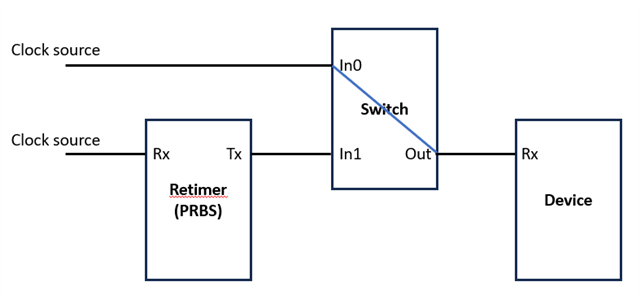

  • Hi Drew,
    Regarding question#4, here is a block diagram. Can you please help to check if there is any problem when the switch is connected to In0 and retimer is working mode(no data output but enabled)?
    Ling
  • Hi Ling,
    You can have a MUX in the signal chain as you have shown.  You will need a high speed MUX in order to ensure good high speed performance.
