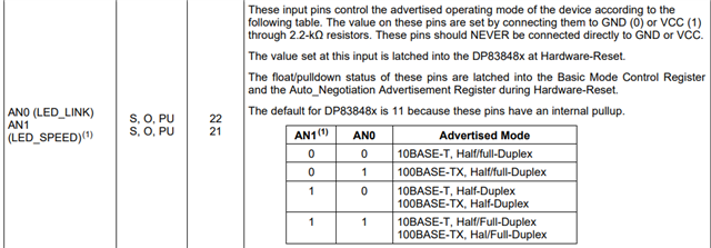

  • Hi Takumi-san,
    I received your email.
    I reviewed the schematic and the register settings.
    It looks like the customer's auto-negotiation advertisement is set to 100M half/full duplex.
    According to the schematic, the auto-negotiation pins are set to AN0 = 1 and AN0 = 0 which advertises 100M half/full duplex mode.
    I confirmed this with ANAR register (0x0004) bit 7 and 8 being 1.
    I also confirmed that 10Base-Tx bits in the ANAR register is 0; hence those advertisements are off.
    To change the advertisement, you can toggle them after the PHY powers up, or change the pin strap to AN0 = 0 and AN0 = 0. So, for both pins, they would be pulled down to GND at the PHY power-up.
    Please let me know how this goes.
    J

  • Hi Takumi-san,
    2) To solve this issue, both settings should be 10M mode.
    That is, you should set pin AN0=0, AN1=0, ANAR register bits 6 and 7 should be set to 1, and bits 7 and 8 should be set to 0.
    Is this correct?
    Your understanding is correct.
    How will DP83848K behave if the pin settings and ANAR register settings are different?
    So, it is okay to change ANAR register settings after the device powers on. However, I noticed that the customer's board had option to change the pin strap setting to force the device into 10M mode so I would recommend the customer to populate such resistor. Then, the customer wouldn't have to change the resistor setting every time the device powers on.
    The pin setting is as such:
    To set 0 on pin strap, the customer needs to connect AN0 to GND with pull-down resistor of 2.2k.
    Please let me know if you have any questions.
