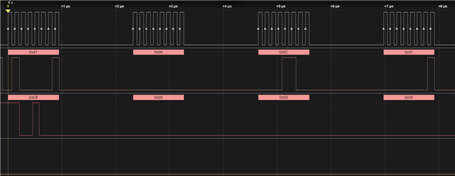

I am working on getting the TCAN4550 working on a SUB1 CC1310 microcontroller, and having trouble getting the CAN initialised.  I believe the SPI is now correctly setup, with the following settings:
    spiParams.frameFormat  = SPI_POL0_PHA0;
    spiParams.bitRate =     8000000;
    spiParams.mode         = SPI_MASTER;
    spiParams.transferMode = SPI_MODE_BLOCKING;
I am using the TCAN4550 demo software, in order to initialize the TCAN chip, but i am unable to write to the TCAN chip. During a read of the Error status register (0x000C) it reads the following:
0x18 0x00 0x00 0x0C which would mean there is a write error and an internal interrupt error.
I am unable to resolve this issue by looking at the data sheet, are there any steps i can take to debug the process?
This is a snapshot of the SPI communication.
Any help would be nice.
Kind regards
  • Hi Thomas,
    Most initial SPI bring up issues are related to the chip select signal transitioning incorrectly relative to the data.  The clock to data polarity looks correct, but I can't see the full SPI transaction including the nCS signal.
    The TCAN4550 requires the nCS signal transition Low at the start of the SPI Read/Write transaction and remain low until after the data portion is complete.  For a single register read/write, this means the nCS signal must be low for a total of 64 SCLK cycles (or 64 bits).
    The device uses a FIFO on the SPI Interface to handle the SPI clock frequency to the OSC clock frequency domain crossing so it keeps track of how many bits are input and output from both sides of the FIFO.
    On the SPI side, if there is an incorrect number of SPI clock cycles detected while the nCS signal is low, then there is either too few or too many bits in the FIFO which results in an error.
    Likewise if there is an issue with the OSC clock (crystal or single-ended CMOS clock of either 20MHz or 40MHz), then the digital core can't process the data resulting in errors.
    Note that registers 0x0000 to 0x002F only require the SPI clock and are implemented in logic.  They are generally related to status information about the SPI FIFO interface.  But all other registers in the 0x0800 and 0x1000 domains require the OSC clock to be functional for a SPI read/write to be successful.
    Common things to check when getting initial SPI drivers running is that the nCS signal is low for exactly 64 clock cycles on a single register SPI read with Length field equal to 1.  By default a lot of MCU SPI driver functions set the nCS after every 8, 16, or 32 bits of data depending on how many bits it can process at a time. If nCS is pulled high before the correct number of cycles, this will cause the TCAN4550 to abort the SPI read and not provide the requested data on a read, or discard the data on a write to avoid corrupting the device with possibly invalid data.
    Also, the SCLK signal should be low while nCS transitions low at the start of the transaction to ensure the first SCLK edge is a rising edge.
    Your clock to data phase relation already looks correct and data is sampled on the rising edge of SCLK.
    Can you capture the complete SPI transaction showing all 4 SPI signals including the nCS transitions?
    Jonathan

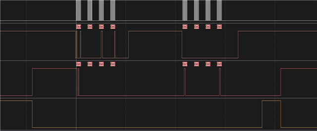

  • Dear Jonathan,
    Thank you for your reply.
    I checked if the nCS signal is low for 64 cycles. Here is the proof of that:
    I also checked if any of the interrupt enable flag registers on 0x0820 were able to be read, to rule out the OSC clock issue. I am able to read out the registers properly.
    Still, the initialization example code is not initialising properly, as the TCAN4550 will go to sleep after 3 minutes.

  • Hi Thomas,
    I still see bit 3 of the Interrupts register 0x0820 getting set to 1 which is the SPI Error Bit (SPIERR). Can you read the Status Register 0x000C so that we can get more information about why the SPIERR bit is getting set?
    To prevent the device from entering Sleep Mode after 4 minutes, you simply need to write a '1' to the PWRON bit in the Interrupts register (0x0820[20]) or configure the MODE_SEL field in the Modes of Operation and Pin Configuration registers to "10" for Normal Mode (0x0800[7:6]).
    Can you try to simply read registers 0x0820, 0x000C and then write '1's to the set bits in each or just a blanket "0xFFFF" to both of these registers and read them back?  Any set bits should have been cleared.
    Please also try to write a custom value to the Test Register and Scratch pad and then read it back as a test that both the SPI Write and Read functions are correct.  You should read back the custom value you just wrote to this register.
    Can you also try to read back all of the device registers at the end of your configuration sequence into a log file so that we can compare the actual register values being written by the code and identify any errors?
    Jonathan
