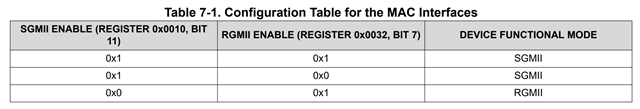

My customer would like to communicate with SGMII forced 100BASE full-duplex, but the link did not established.
Please tell me the configuration to achieve this.
Is the following understanding correct?
Please tell me if there are any other important settings.
To use the same hardware with and without Auto-negotiation, they plan to enable Auto-negotiation on the strap and disable it with software.
<Forced 100BASE full-duplex config>
Register 0x0000 [6,13]=01(100Mbps)
Register 0x0000 [8]=1(Full Duplex operation)
Register 0x0000 [12]=0(Auto-Negotiation Disabled)
Register 0x0014 [6]=0(Disable SGMII Auto-Negotiation)
