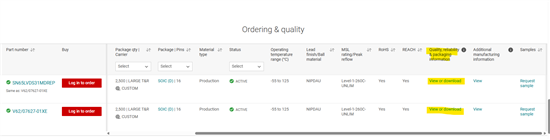

What is the weight of the SN65LVDS31MDREP?

ti.com/quality-reliability-packaging-download/report?opn=SN65LVDS31MDREP says 160.797339 mg.
Hi Adam,
You can find the weight of any TI device by navigating to the quality and reliability page.
You can either go to the individual product page, scroll down and select the "View or Download" link:
Or you can go to the general quality page and search for multiple parts at once:
https://www.ti.com/quality-reliability-packaging-download/
Once you are viewing the specific device, scroll to the bottom of the "Material content" section and there will be a total weight listed.
Let me know if this helps or if you have any further questions!
