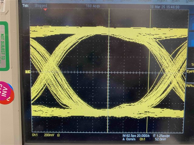

We are testing 5 prototype systems with DS90UB635 / DS90UB638 pairs.
4 of them are performing well.  One reports unstable Lock and Pass.
We enabled CMLOUT per the data sheet instructions and the eye diagram looks very good to me.   We are connecting in twisted pair configuration, over a short link, in 2Gbps (half rate) mode.
It does not appear that the 638 registers support the necessary functionality for the "Margin Analysis Program" testing.
Can you offer any additional debugging techniques we might use to understand why Lock and Pass fail so frequently on this particular system?
  • Hi Barry,
    Have you tested the failing DES board with a known working SER board?
    Have you tested the failing SER board with a known working DES board?
    How you tested with a different cable type and length?
    Can you provide register dumps from SER and DES, from a working system and a not working system?

  • Thanks for the analysis.  I went through the whole list and came to the same conclusions.
    The curious thing is the link is short and the CMLOUT looks clean.
    I think we will try manually setting the EQ in Register 0xD4 to test lower values.
    Does that offer any chance of working?
  • I think we will try manually setting the EQ in Register 0xD4 to test lower values.
    Not sure if that will make any improvement, but you can give it a try.
    Can you also check DES reg 0x41 value should be 0xA9.
  • Thank again for the help.  I really appreciate it.  Your comments helped us put together a test to diagnose the problem.
    We found 2 things:
    1. Running with CMLOUT enabled destroyed our incoming reliability.  The register logs I sent were taken with CMLOUT enabled.  Once we disabled CMLOUT, the issues were 10x better, but not fixed.
    2. The root cause turned out to be EMI from a noisy high voltage switching supply.  After applying some filtering to that supply, we saw the errors disappear. Auto-equalization now initializes at a low setting and the parity and CSI errors are gone.
