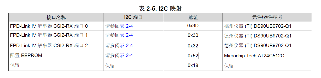

Hi Ti team,
    I am currently using the board J784S4XEVM+J7EXPA01EVM. (The 12V power supply is provided on the J19 port of the J7EXPA01EVM board.)
    Referring to the following I2C communication table information, the relevant i2c devices cannot be read correctly.
   Here are my steps and the corresponding log output:

root@j784s4-evm:~# i2cdetect -y 8
Warning: Can't use SMBus Quick Write command, will skip some addresses
     0  1  2  3  4  5  6  7  8  9  a  b  c  d  e  f
00:
10:
20:
30: -- -- -- -- -- -- -- --
40:
50: -- -- 52 -- -- -- -- -- -- -- -- -- -- -- -- --
60:
70:
root@j784s4-evm:~#
root@j784s4-evm:~#
root@j784s4-evm:~# i2cdump -y 8 0x3d
No size specified (using byte-data access)
     0  1  2  3  4  5  6  7  8  9  a  b  c  d  e  f    0123456789abcdef
00: XX XX XX XX XX XX XX XX XX XX XX XX XX XX XX XX    XXXXXXXXXXXXXXXX

root@j784s4-evm:~# i2cdump -y 8 0x52
00: ff ff ff ff ff ff ff ff ff ff ff ff ff ff ff ff    ................

root@j784s4-evm:~# i2cdump -y 8 0x18
00: 30 00 33 48 00 03 01 28 fe 1e 11 7f 7f f0 0f 00    0.3H.??(???????.
10: 00 00 80 00 00 20 18 f1 61 00 c0 00 00 10 00 00    ..?.. ??a.?..?..
