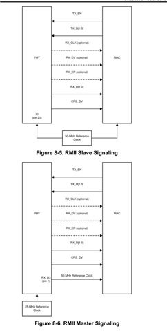

Part Number: DP83822I
Hi
How do I decide which mode to choose, RMII master mode or slave mode ?
Any advantage or dis-advantage comparing this two mode ?
Thanks!
Hi PY,
From this related E2E, the only difference between master and slave mode is the reference clock used by the PHY.
Shane
