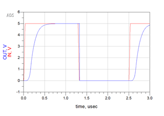

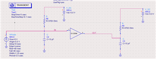

    I simulated using the following schematic and TCA9617B IBIS model. However, it looks like the IBIS does not model the pedestal or static voltage offset output correctly.
