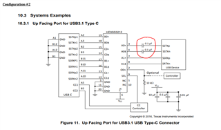

Part Number: HD3SS3212
One of my customers noticed a difference in the placement of AC Coupling caps within the datasheet. We just wanted to check to ensure both configurations are correct -
Thank you!
Thank you!
Hello Abigail,
Yes, both configurations are correct, but probably a little better to put them before the mux.
Nir
