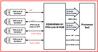

Can we use Two Cameras with STP cable and 2 Cameras with Coax cable to interface with DS90UB960.
Is there any challenge using two different cables ? as shown below

Hi Dilip,
The configuration depicted in the image is possible. Each FPD RX port of the UB960 can use either STP or coax.
