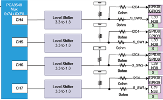

hi
I would like to ask can I connect PCA9548A to multiple level shifter ? before connect to end device ?
Hi ,

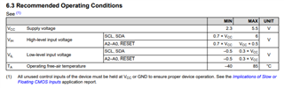

May I know what is the range of I2C level that supported by PCA9548A ?
as the datasheet information and block diagram is in different range.
For the supply to PCA9548A, if I am level shift it 3.3V to 1.8V, then I have to ensure the supply is 1.8V ?
Hello Woon,
The range for the I/Os is up to 5.5V.
The supply can't be below 2.3V.
You need to implement external pull-up resistors to pull the bus up to the desired voltage.
