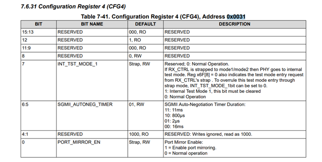

  • Hi Asano-san,

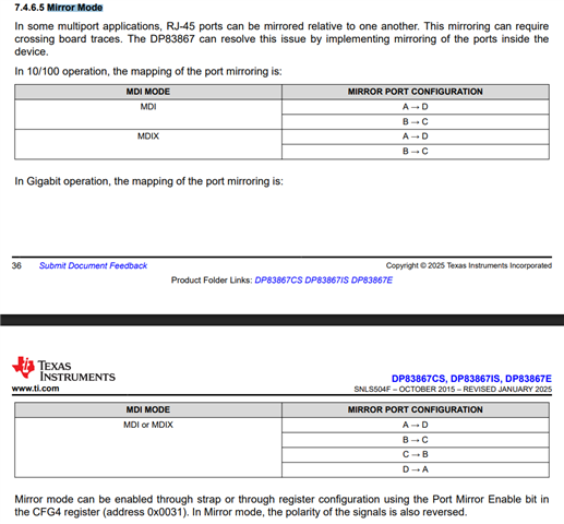

    Looking at the register setting, it looks like mirror mode is enabled. If the mirror mode is enabled, the PHY won't be able to make connection if the connection wasn't mirrored as the polarity of the signals is also reversed.
    This can be disabled via strap, or register configuration using the port mirror enable bit in 0x0031.
    The following is the pin strap information for mirror enable.
    In addition, if you could provide the data on the register 0x0004 (auto-negotiation advertisement register), we can assist you on debugging should mirror mode was not the issue.

    As you mentioned, value of the register 0x0031(CFG4) in the Link-"DOWN" state is 0x10B1, and 'PORT_MIRROR_EN' was set to 1.
    After that, following your advice, I have set 'PORT_MIRROR_EN' to 0.
    (The register 0x0031 is the extended register and must be accessed according to 8.6.12 "Extended Register Addressing", correct?)
    As a result, values of the registers are as follows, and link-up has been successfully established!!!!!!!
    - Register Address = 0x0031, value = 0x10B0
