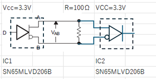

I have some question about using SN65MLVD206B.As shown in the figure below, the SN65MLVD206B is used for both the driver and receiver.
The M-LVDS is 100 ohm terminated. The M-LVDS line has an amplitude of 1.0 V on the P-side and 1.0 V on the N-side.
The amplitude seems to be large. Is there a problem?
Is there any problem with 100 ohm termination for M-LVDS line?

    M-LVDS is intended to be double terminated with 100 Ohm resistors to achieve an equivalent resistance of 50 Ohms. Please see this App Note for more details.

    Is there anything I should be aware of when connecting only two devices with M-LVDS?
    The amplitude of the signal is higher than M-LVDS level.
    "M-LVDS is intended to be double terminated with 100 Ohm resistors "
    That means 100 Ohm termination is required for both transmitter and receiver?
    Currently, only the receiving end is terminated by 100 ohms.
  • The differential voltage is higher than normal, but that is no problem for the receiver.
    As Clemens said, the receiver can handle the higher differential voltage just fine as the Recommended Operating VID (max) is Vcc.
    The M-LVDS spec says that M-LVDS buses should use 50 Ohms of termination resistance. That is why the datasheet parameters for M-LVDS devices are given for a load resistance of 50 Ohms. Typically, best performance is realized when two 100 termination resistors are used in parallel as compared to a single 50 Ohm. In your case it looks like you are only doing point-to-point communication, not multipoint, so double termination might not be as critical. The only concern would be signal integrity if you are driving a 50 Ohm transmission line. Using a single 100 Ohm termination resistor will create more reflections than the matching 50 Ohm would. Depending on your datarate and layout, this might not be acceptable.

  • Hi, Jack
    Thank you for a more detailed answer.
    I understand that the current circuit is not a big problem.
    However, I would like to improve the waveform as there is an overshoot.
    I would like to change the terminating resistor. Which is better, a or b in the figure below?
    Hyodo
  • Hi Hyodo,
    I would recommend option B (two 100 Ohms) as that is the typical topology for M-LVDS systems. One resistor should be as close to the driver as possible and the other should be as close to the receiver as possible.
