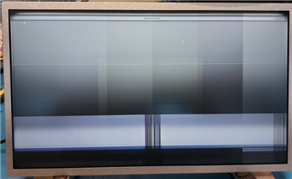

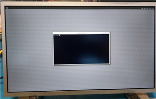

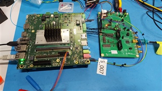

Hi, we have a problem with our actual prototype setup.
We are using a i.MX 8QuadXPlus with yocto as LVDS source for a DS90UB947-Q1. For the actual setup an eval-board is used for the i.MX8 and a DS90UB947-Q1EVAL as serializer.

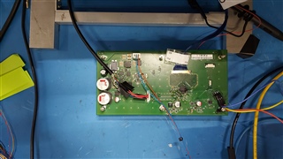

The deserializer (DS90UB948-Q1) is placed on our prototype-PCB which is connected to a display with a resolution of 1920x1080 points at 60Hz. The display is an InnoLux G156HCE-L01. The connection between display and PCB is realised with 20cm long micro-coax-wires.

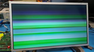

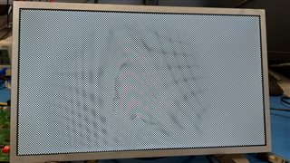

After the setup is powered up, we get the following picture:

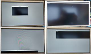

So far it seems all to be fine, but if this window is maximised or moved over the displayed window-borders, the following is displayed:
If the same display is connected directly to the eval-board of the i.MX8, the picture remains intact.
The registers of the serializer and the deserializer are set to the values shown in the excel-sheet.

    Have you tried doing 948 PATGEN and also 947 PATGEN before doing end-to-end video? Were these successful?

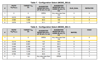

    Based on the register configurations, It seems you are in FPD single-link mode, STP, and dual OLDI input with OLDI bit mapping for the 947, and dual OLDI output for the 948. Can you please confirm that this is what you intend to program for your system?
    947 Configurations
    948 Configurations
    Lastly, I want to confirm - any movement of the window will cause this exact glitch to occur? If you could provide a video of the glitch happening, that would help a lot.

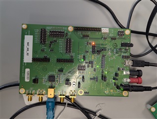

  • Hi Esther,
    thanks for your quick response.
    I have mainly provided technical support for the project so far and am not yet 100% familiar with the subject matter. My colleague is on vacation at the moment and I hope I'm getting everything right.

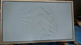

    My colleague used the PATGEN on both the 947 and the 948 to generate testimages on the display. This worked in both cases.

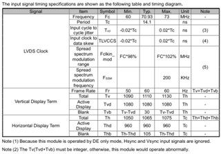

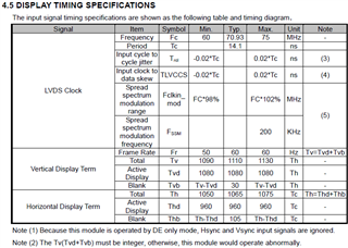

    The information for the display is shown in the following picture:
    According to this table, the total PCLK for the complete signal will be (2*1065) * 1110 * 60Hz = 141,858 MHz.
    The pictures you added are for the Mode Select Pins.
    The hard-wired settings for the 947 are:
          MODE_SEL0 = 1,008V (5) = OLDI_DUAL=1 & REPEATER=0
          MODE_SEL1 = 0,383V (2) = MAPSEL=0(OpenLDI) & COAX=0
    The hard-wired settings for the 948 are:
          MODE_SEL0 = 1,241V (4) = Dual OLDI output, MAP_SEL=1(OpenLDI) & OUTPUT_MODE= 00
          MODE_SEL1 = 0V (2) = REPEATER=0, MODE=00, HS_BackChannel=5Mbps & Input = STP
    At start-up of the Yocto-system some registers are set to new values. The configuration over the I2C-connection works well.
    We are using a dual link STP connection between 947 and 948 and it shall be detected automatically (standard-setting). The dual-OLDI input and output is the correct setting.

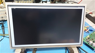

    Regarding the window-problem: Moving the window pn the screen works and it can be moved to each edge. The problem occurs, if the window is maximised or enlarged (see videos).

    Thanks for the information and video! If DES and SER PATGEN are both okay, then we can isolate the issue to the path between the SoC and the 947. Also, the mode straps are fine and the PCLK is in range, so we can rule out hardware.

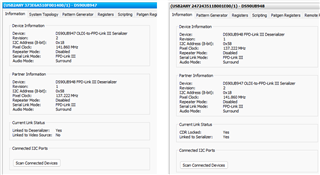

  • Hi Esther,

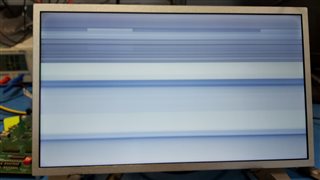

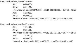

    today I have modified the test-setup and i have connected the display directly to the eval-board with the i.MX8. The displayed screen is OK and maximizing and resizing makes no problems.

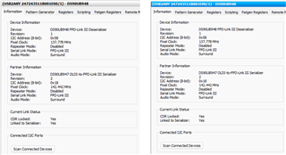

    In the "Exploring the Test Pattern Generation Feature..." document (SNLA132G) is in chapter 4.5 a "Resolution Readback Example"described. I executed the example over I2C once with the "intact" screen and once with the "crashed" screen.
    Is seems, the resolution is not correctly reconstructed by the deserializer. The SoC generates a resolution of 1920*1080 pixel.
    What may be the reason for this condition? A config-problem or a signal-problem?
    Best Regards
        Dirk

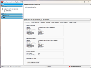

  • Hi Dirk,
    Are you running a specific script for this configuration? Can you please provide this script?
    Do you have local I2C access to the 948? If you do, can you run MAP analysis on the 947-948? It could be a link integrity issue causing the incorrect resolution being reconstructed at the DES. Here is some information on how to set up MAP Analysis.

    for first tests, we started with i.MX8 eval board, serializer eval board, deserializer eval board and display.
    The discribed problem occured when we replaced the deserializer eval board with our hardware.
    The MAP Analysis is only on the 948 available und for a first MAP analysis try I can use the "old" setup for getting a reference measurement. As second step I use the USB2ANY connector for connecting our 948 hardware over i2c and then making a further test. (Before I start the test, I wanted to check my thesis, that I can use the 948 eval board in the described way...)
    Yes, that works. Appreciate you checking in.
    Just to confirm, there were no abnormalities with the display when using the deserializer eval board?

    Since the signal integrity on the 948 board and evaluation board are both okay, it may implicate the 947.
    Lastly, if it's possible to get reg dumps of normal vs abnormal screen for both 947 and 948, that would be great.

    here are some pictures using the 947 pattern generator:
    1) Using the pre-defined settings for a 1920*1080 60Hz display:
    The displayed pictures are OK and I could see no errors. Unfortunately these settings produce only 40.4 frames/second, not 60 frames/second.
    2) Using the settings from the display (G156HCE-L01):
    If the "Scale by 16" is unchecked, the picture shows this:
    and the bars are running... A white picture or a picture starting with white is also no good choice:

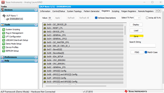

    Is it possible for you to locally access the 948 evaluation board, and bring up 948 PATGEN (with the 947 disconnected), and play with some of the settings (like unchecking the scale by 16) to see if it also breaks the screen?
    Is it possible to store a register dump with the ALP-environment? I will try to make some dumps tomorrow.
    You can go to the Register Tab and click Save to export the register data. Thanks!

    for the following tests I used the 947 eval board and the 948 on our hardware connected via I2C to the USB2ANY connector.
    The problem with the 948 eval board is that we always have a faulty image, regardless of how it is generated.
    I used the 948 to generate the picture for the display. If I use the internal source, only a pixel clock of 70 MHz can be selected and this works.
    For a higher pixel clock I used the 947 eval board with the descibed settings as source, but with the external clock, I got no good output...
    Screenshots "Information" for the testsetup with 947 eval as source:
    Here the register-readouts for this test (as txt, because nrd was not accepted).

    Something I do not understand, is the frequency counter:
    • Serializer, register 0x1f
    • Deserializer, register 0x1b
    The LVDS-Signal comes with a clock of 141,86MHz.
    The frequency counter of the SERializer shows 145MHz.
    The frequency counter of the DESerializer shows 138MHz.
    These frequencies are approximations - OK - but doesn't the frequency to create a signal at 141,86MHz have to be higher or at least the same?
    BR,
        Dirk
  • Hi Dirk,
    This register gives a rough estimate, so it will be more accurate to probe the actual pins.

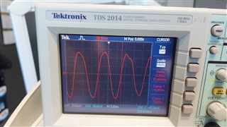

  • Hi Esther,
    I recorded the clock-signal for one LVDS-channel... since I only had a 100MHz oszilloscope and only normal probes available, I hope, thats the reason, why the whole signal looks a bit sine-wavey...
    The good thing: I had a picture even though I influenced the signal in this way.
    It seems that it has no influence on the clock whether I created the error on the screen or not.
    BR,
        Dirk

  • Hi Dirk,
    Can you ensure the power rails are within device specifications?
    Also, is it possible to send a schematic of your 948 hardware board?
    We're trying to replicate this issue in the lab with our EVMs, but no luck so far Disappointed
    Additionally, I've attached a picture of all the default jumper configurations and the mode straps you listed for the EVMs. Please make sure your setup aligns.
    Lastly, can you provide a picture of your setup?
    BR,
    Esther

  • Hi Esther,
    we have found the problem. The boards are working perfectly and the settings were all correct. (Only our 948-Eval Board is definitely broken.)
    The fault was between the deserializer and the display...
    The only ready-made cables you can buy for the display-connector (I-PEX 20455-040E-76) use 40 micro-coax wires.
    In the first test-setup the cable was only 5cm long and the rest of the length was solved using normal strands. This worked, but was relatively sensitive.
    On our finished circuit board, we use the same connector as the display and a ready-made cable with a length of 20cm in between.
    For a complete white picture, the display requires a maximum current of 1.5A at 3.3V (datasheet). All other colors need less current. The frame of the window is also a very whitish gray. Depending on the size and position of this white area, the error occurred.
    The voltage drop accross the power-lines was too big and the display-controller went crazy. When the displayed image became darker, the voltage was back within the permitted range and the display controller worked properly again.
    We have now extended or testsetup so that we have laid a stranded wire paralle to the power-lines. Since we made this adjustment, everything has been running as it should.
    Even if you no longer need it, here is our test setup and a picture of the screen with a large window.
    We really thank you for your support with our problem and I hope that the start-up of the serializer will not present us with similar problems.
