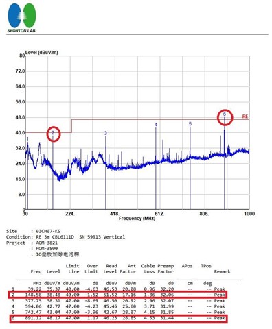

There is a project using TMDS181 in customer board. The HDMI points fail to meet the requirement of Class-B:
891MHz: over spec of 1.17dB
148MHz: the margin is only 1.52dB, which has risk.
Test results:

    148MHz would be the speed of the HDMI CLK signal and 891MHz would be the 5th harmonic. Its possible this is a CMC issue however I have a few questions to be sure:

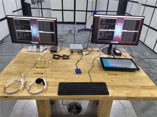

    3. Can you show a block diagram of the test setup used for this EMC test? If the HDMI cable used is not shielded it can be a source of emissions.
    148MHz*5=740MHz. I'm confused why 891MHz is the 5th harmonic?
    you can see as figure for the EMC setup, yes, the cable is shielded.

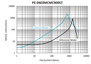

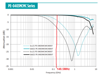

    1. What you want is a CMC that attenuates the signal at 148.5MHz. I see a CMC on Digikey with the part number PE-0403MCMC900ST. In the datasheet there is an attenuation plot:
    This device would be optimal (highest attenuation) around 700MHz - 800MHz based on these plots. If you're able to find a similar part that optimizes attenuation around 148MHz that would be ideal.
    Side note: You're right about the harmonic. 891MHz would be the 6th harmonic of 148.5MHz, which is the CLK frequency for HDMI. Apologies for the confusion here.

    3. Are you able to remove the monitors/screens/devices/etc from the chamber when running the test? These could be contributing to the noise you're seeing. Please also try using multiple different cables. I see from this previous E2E that a customer has used a cable with integrated ferrites to help reduce emissions.
    Do you have any recommended part? But my understanding is that the common-mode impedance curve reflects the common-mode insertion loss curve to a certain extent. Considering the packaging, impedance, and process technology, it should be difficult for a 90ohm@100MHz common-mode inductor to form a large impedance or insertion loss at 148MHz. I also checked the common-mode inductors of Murata and Panasonic, and the common-mode insertion loss listed is within 2dB of the value shown in your figure. Unless you choose a common-mode inductor with a larger value at 100MHz, the SI should also be affected.
    We have tried different cables and monitors in different labs, and there are differences. But now we want to see if there is room for optimization of the HDMI line when the board/design is revised. In addition, the lab that Advantech pre-tests is not the same as the lab that does the final certification. If the certification fails, the certification lab will not deny the cables and monitors that their labs have verified to be problem-free in other cases just because of this case.

    Yes you are right that the common mode impedance and insertion loss curves are correlated. I don't have a recommended part in mind, so I want to clarify that the higher common mode impedance and insertion loss the CMC has at 148.5MHz, the better it will block this frequency of noise on the CLK signal. If you can't find a better CMC for 148.5MHz, we'll need to think of other ways to reduce this emission.

    My understanding is this test should be done with only the DUT in the chamber. If there are monitors/other devices in the test chamber then you are not only measuring the EMC emissions from the DUT, you are measuring the emissions from every device in the chamber. Does the certification lab not isolate the DUT when running this test?
