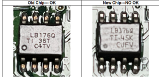

SN65LBC176: Why the internal pins structure of the NG IC mentioned by customer is different from other silk screened IC ?
Part Number: SN65LBC176
Dear Expert

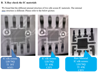

We found below to request traceability for GEPN: Z129-0028 chip U2 Rs485 in Bus board p/n 17M9-0021. Also, we have noticed serigraphy differences between chip that shows failure and chip that work OK.
Issue 1:Why the internal pins structure of the NG IC mentioned by GE customer is different from other silk screened IC ?
