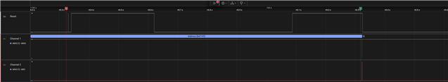

Hello, we are using the DP83867E as a RGMII PHY connected to a Jetson AGX Orin and struggle to get a stable connection.
We have RX_CTRL strapped to Mode 3 and the remaining strap pins set to Mode 1.
During testing we have been able to get a network link by leaving the RESET_N pin disconnected from the Jetson PHY_Reset, and connecting the RESET_N pin to VDDIO through a RC circuit so that after a small delay the pin gets pulled up and stays high. With this setup we have verified that our hardware setup is correct, and we are able to have successful MDIO communication and internet connection.
When having the Jetson PHY_Reset connected we observe an issue where exchanging MDIO messages fails and the reset line gets pulled low by the Jetson.
After connecting a logic analyzer, we are able to see the Jetson PHY_Reset behavior and MDIO packages. Marker 0 is where the reset sequence starts. Marker 1 is when MDIO communication is attempted.
jetson_reset_and_mdio
Zoomed in section of the attempted MDIO communication:
The Jetson attempts to read the registers 0x02 and 0x03, but the operation fails. The PHY does not pull down the MDIO line during turnaround and a value of 0xFFFFF is read, even though at that time the reset is high.
What could be causing this failure to read the MDIO data ?
Is it a viable approach to just have the RESET_N pulled up through a RC circuit and not connected to the Jetson ?
    When the Jetson connection on reset is present, the SMI functionality fails, while when this connection is absent, the SMI functionality is all good? This may lead to initialization concerns if the reset may be affecting the SMI functionality. It is viable to have RESET pulled up; in fact there is internal PU resistor on the pin if the external pin is left not connected. Having external connection is warranted when customers want to externally pull down the pin for intentional HW reset.

    Correct, when the Jetson reset connection is present the SMI functionality fails, and when it's not connected but pulled up through an RC the PHY works but also not always, around 70% of the time.
    So is it ok to not have the reset line connected ? If we can confirm that the PHY can be fully functional without it then we could remove it from our design.
    Are you able to give any insight based on the images from the logic analyzer? The attached section shows a case where the PHY went through a reset sequence but still fail to respond on MDIO. Could it be related to timing of the pulses?
    It appears that the issue lies on the SoC controlling the reset line then. It could be issues with initialization, or resetting during a transaction which confuses the state machine.
    If you are okay with not having the line connected to SoC, PHY can still function with this pin PU.

    We have done that at least with the logic analyzer and the reset signals the SoC sends are the same, no matter if the PHY is connected to it or not. (Except that the reset line is not being pulled low if the SoC successfully establishes communication via MDIO in the disconnected case)
    Measuring the PHY-side of the reset line, when it is disconnected just keeps the signal out of reset for the whole time.
    A logic analyzer would digitize the result to be pure high/low, while a scope would provide better insight on whether or not there is signal integrity issue (rise/fall issues, reflection, setup/hold, weird glitch, etc). I wanted to see this information as it could provide better insight on the electrical characteristics of the timing.

    We have checked the analog signal with the Logic Analyzer. The signal is not as precise as with an oscilloscope, but it looked pretty much how we expect, with good step function behavior.
