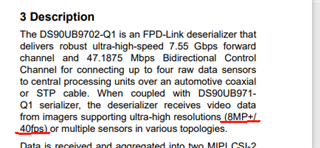

I am evaluating DS90UB971-Q1 and DS90UB9702-Q1 for 4K video transmission, I saw in the document that DS90UB9702-Q1 supports (8MP+/40fps), I want to know whether they support 3840*2160*60 RAW10/12 video transmission.
Thank you very much.
    With the above resolutions and data type you can support up to 48 FPS.
    For using 60 FPS it should work with 10-bits data type and keeping the imager blanking to max 15%.
    12-bits data type need reduction of the frame rate to max 52 FPS.
