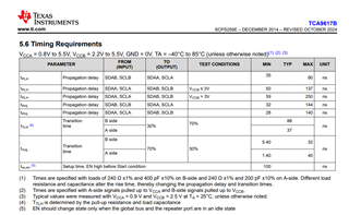

Part Number: TCA9617B
This is an I2C buffer.
Are there any documents that specify the I2C input/output timing?
The TCA9617B itself is not an I²C device, i.e., it does not have its own I²C address. It just passes through I²C signals between the two sides, and does not have any requirements for their timing.
When you insert the TCA9617B between other I²C devices, then the signals are slowed down due to the propagation delays (see section 5.6). This can affect the setup/hold time requirements of these other devices.
