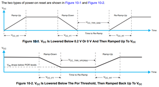

Part Number: PCA9545A
Hi team.
What's the difference between those two kinds of POR? Which one should we choose?
Hi team.
Hi Naizeng,
This part of the datasheet has caused confusion the past but this POR reset description across many of TI's i2c devices.
Kameron
