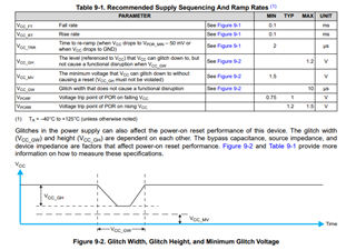

    The TCA9539-Q1 will reset only when either /RESET goes low or when the supply voltage dips (see section 9.1). Shorting SCL to GND while another device is actively driving SCL high might cause the supply voltage to go down.

    Can we confirm that /RESET is always HIGH on the oscilloscope during the SCL to GND condition?
    What is the state of VCC?
    Is the customer abiding by the glitch width, height, metrics in the datasheet to prevent a power reset?
