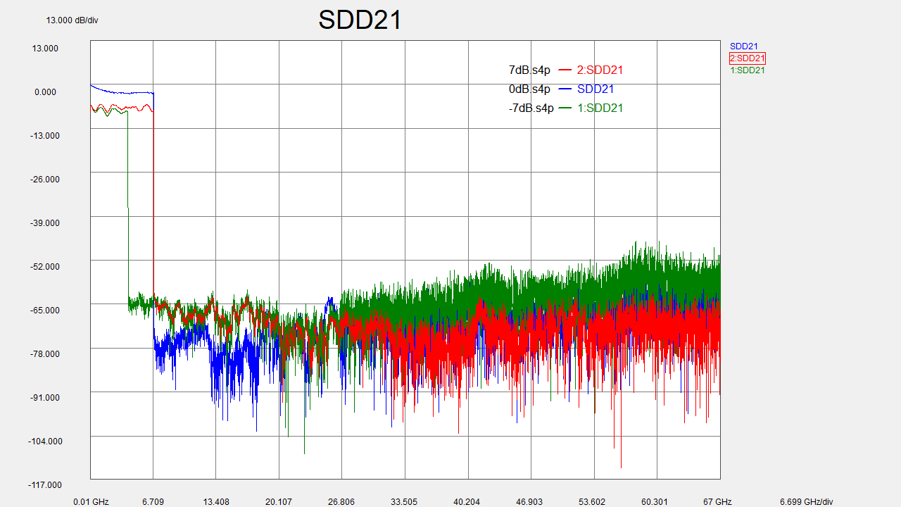

Part Number: DS560MB410
While using the DS560MB410 chip to create an ACC, I noticed that regardless of the EQ compensation value settings, the S21 parameter drops sharply at 6.76GHz during the measurement of S parameters. This seems to indicate that the link breaks when the frequency exceeds 6.76GHz. What could be causing this? Is there a specific register that needs configuration?
