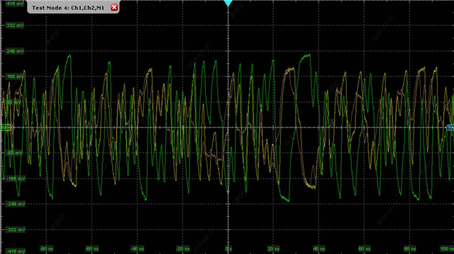

During the PMA test, there are a failure. What could be the possible causes? How can we optimize it?
① Transmitter distortion, test mode 4 ,fail.The waveform is abnormal.
  • Hi Jiang,
    Can you tell us more background information?
    • What kind of project are you using the DP83TG720 in?
      • Has TI reviewed the project details before? Do you have a TI FAE contact?
    • We have a public application note describing how to configure the DP83TG720 for compliance tests, section 4 describes PMA tests
      • Did you follow all of the steps described, including the master/slave register initialization sequence after powerup and switching to the appropriate test modes for the different tests?
