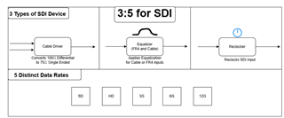

Hello SDI engineers and LMH enthusiasts,
Figure 1 - 3:5 for SDI
In this E2E FAQ, I will be discussing GND plane layout best practices for SDI designs. In cable driver designs, see figure 1, SDI data transitions between 50 ohms differential and 75 ohm single ended characteristic impedances as the means of transport.
