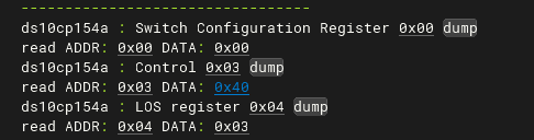

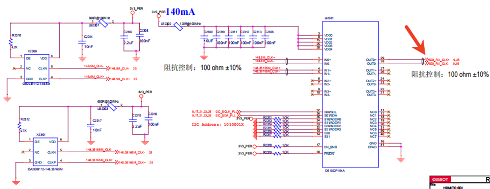

The new project is using DS10CP154A, but there is no output during testing. Please help check the schematic diagram and configuration. Thanks.

Can you share the wave forms of the signal going into the mux and the signal going out of the mux?
Are you able to try setting the part up in GPIO mode?
