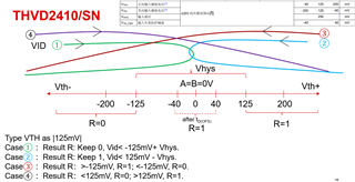

Hi Team:
 i know to config out why the 485 device have different Vth setting, so i compare THVD2410 VS THVD1400 here.
THVD1400:
THVD2410:
First, for THVD1400, i summary like below VID w/ Vth±:
base on it ,we can know when the A=B=0V, The Vid=0V>-45mV, and make the R output 1, and the -45mV maximum value ensures that even under the worst process, VID=0V still has at least 45mV noise margin (0V-(-45mV)=45mV).
so what about the VID range of -150~-70mV? what s the R output behavior?
For THVD2410,  it will have fail-safe mode to make sure the Vid range (-40~40 ) will make R output 1.
and for the Vth+ and Vth-, does it also get the R=0 when Vid<-40mV?  and R=1 when Vid >40mV?  or  we should follow below ±125 threshold? but what about the Vid drop into the range of (-125~-40) and (40~125)?
tks for the comments here.
  • For the THVD1400, for VID between −200 mV and −45 mV, the output is undefined.
    For the THVD2410, for VID between −200 mV and 200 mV, the output is undefined. For VID between −40 mV and 40 mV, after tD(OFS), the output is high.

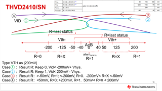

  • Hi Clemens ,
     tks for the comments here. it is clear of the behavior now.

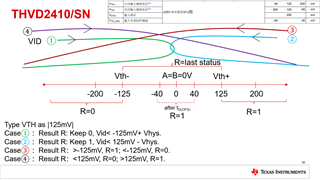

     but due to the Vid may have chance cross over this range and our Vth± also have a range, so  we need to take care of it with our Vhys too. so what the suggestion when we do not have the pullup & pulldown R for the bus here?
    for example: there may be 4 status like ①②③④ may cross over or go through it on THVD2410,
    base on ±125mV typ Vth discussion:  i think there is no need for pull up/down R here. 250mV Vhys can cover the -125mV~ 125mV undefined range. am I correct?

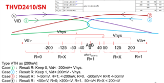

    but base on the ±200mV max Vth discussion:  i think there still have a undefined range like :
    -200mV< R=X <-50mV
    50mV< R=X < 200mV
    so this is the risk for no pull up/down R here. am I correct?

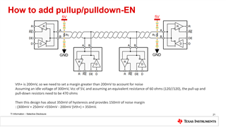

    if add a pull up/down R here, can you help to check the below setting correct or not for THVD2410?
  • When there are no fail-safe biasing resistors, then the termination resistors will short the two bus lines, and VID = 0. In that case, for both THVD1400 and THVD2410, the output will be high.

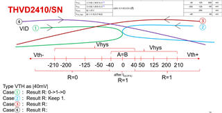

    Vth as 40mV typ, How we handle the (Vth+) - VHYS = 40mV-250mV =-210mV > -200mV when Vid change from high to low? The R will turn to 0 at -210mV or -200mV?
  • For any individual chip, the output is never undefined. ("Undefined" means that different chips might have different outputs.)
    In the first example, the output switches from low to high at 125 mV, and from high to low at −125 mV.
    In the second example with 200 mV, the output switches from low to high at 200 mV, and from high to low at −50 mV.
    In the second example with −200 mV, the output switches from low to high at 50 mV, and from high to low at −200 mV.
    The third examples cannot happen; VTH+ is never larger than 200 mV.

    But ultimately, the hysteresis value is a typical number. Which means that it was derived by taking the typical the typical Vth+ and subtracting it from Vth- (so 125mV--125mV =250mV). The worst case scenario would be 40mV--40mV making up 80mV in theory however these max and min values come with guard bands so you shouldn't actually get a device with these limits.
    It's easier to think of it as Vth+ and Vth- are designed around a specific number (the typical values) but these numbers can move due to process variation and temperature. You will not know this value unless you test each device. Some may have Vth+ at 150mV while others may be 100mV. But if you cross this value, then R will be high. We set the 200mV max as a way to guarantee if this value is crossed the R will definitely be high.
