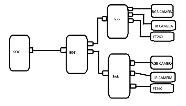

Hi team,
As shown in the system diagram, all USB devices (including HUB) have been successfully enumerated. As shown in log1, only the enumeration logs of three hubs are listed. The logs of the other six devices are not posted. After about 4 seconds, all USB devices are disconnected. And after about another 4 seconds, TUSB8041 is enumerated again, but the PID enumerated at this time is 80ff. The correct enumeration should be 8142.
So under what circumstances will the PID become 80ff?
Thanks!
Attached log
Correctly enumerated log: (Omitted the enumeration log of six USB devices):

The log of all USB devices disconnected:
01-01 08:00:12.686     5     5 I usb 1-1 : USB disconnect, device number 2
01-01 08:00:12.686     5     5 I usb 1-1.1: USB disconnect, device number 3
01-01 08:00:12.686     5     5 I usb 1-1.1.1: USB disconnect, device number 7
01-01 08:00:12.741     5     5 I usb 1-1.1.2: USB disconnect, device number 9
01-01 08:00:12.790     5     5 I usb 1-1.1.3: USB disconnect, device number 5
03-31 09:15:24.788     5     5 I usb 1-1.2: USB disconnect, device number 4
03-31 09:15:24.788     5     5 I usb 1-1.2.1: USB disconnect, device number 6
03-31 09:15:24.841     5     5 I usb 1-1.2.2: USB disconnect, device number 8
03-31 09:15:24.881     5     5 I usb 1-1.2.3: USB disconnect, device number 10
TUSB8041 re-enumeration log: (PID becomes 80ff at this time):
03-31 09:15:28.083   942   942 I usb 1-1 : new high-speed USB device number 11 using ehci-platform
03-31 09:15:28.237   942   942 I usb 1-1 : New USB device found, idVendor=0451, idProduct=80ff, bcdDevice= 1.01
03-31 09:15:28.237   942   942 I usb 1-1 : New USB device strings: Mfr=0, Product=0, SerialNumber=0
