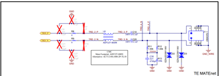

I have some questions about 100B-T1 PHY and PoDL.
You already developed PoDL for DP83TC812S-Q1, which is TIDA-020060 reference EVB.
Did you have the experience of compliance test for TIDA-020060?
I think the inductor for PoDL causes the jitter problem. I want the tips for that.
If you passed the compliance test including podl, I would like to apply DP83TC812S for our project.

  • According to IEEE, we should do compliance test of Jitter, droop, power spectral density, return/modeconversion loss about PHY.
    It is also called PMA testing.
    I think the inductor is connected to MDI signal lines, that causes saging the signal, this means jitter problem.
    If it is wrong, please tell me.
    If you have the information or document about PMA testing of DP83TC812S, please contact me..
    The TIDA020060 has a common mode choke on the MDI lines for Ethernet 1000BASE-T1 (ADF32T-800N).
    A CMC could cause jitter if it is not a large enough inductor.
    4.7μH +50,-30% at 100kHz
     is the ADF32T-800N in the TIDA design
    and
    200 µH @ 100 kHz
    is the DLW43MH201XK2L which is recommended for the 812
    That is a pretty significant difference in inductance. Is the customer currently failing jitter compliance?

    The PMA testing document you have is including podl?
    In the TIDA design, if we mount PID77S-180M, what should we mount at the CMC?
  • Hi Yeseul,
    No, it is just for the DP83TC812. I will check internally if we have PMA compliance documentation with the TIDA.
    https://www.ti.com/lit/ug/tiduf49/tiduf49.pdf
    See table 3-4
    -Nick
    I checked internally and we do not have PMA compliance report with Jitter for the TIDA-020060.
    Nick
