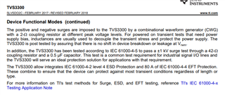

Hi Ti
I use TPD6S300A for PD 20V INPUT
TPD6S300A is not for EFT 61000-4-4
type C CC1/CC2 is fail
let VBUS restart to 5V
I found this
somebody say need add TVS
can you give me design guide for EFT 61000-4-4
Thank you

Please see:
https://www.ti.com/lit/ds/symlink/tvs2200.pdf#page=10
or
https://www.ti.com/lit/ds/symlink/tvs3300.pdf#page=11

this two not for EFT 61000-4-4
Based upon the datasheet, the devices are rated for IEC 61000-4-4.
