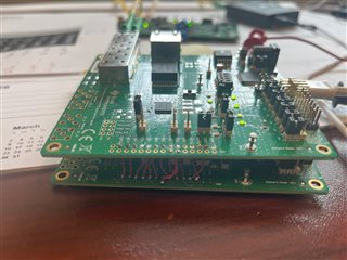

I have two DP83869EVMs, and I have connected them together like this:
RX_CTRL -> TX_CTRL
TX_CTRL -> RX_CTRL
RX_D3 -> TX_D3
TX_D3 -> RX_D3
RX_D2 -> TX_D2
TX_D2 -> RX_D2
RX_D1 -> TX_D1
TX_D1 -> RX_D1
RX_D0 -> TX_D0
TX_D0 -> RX_D0
RX_CLK -> GTX_CLK
GTX_CLK-> RX_CLK
GND -> GND
So, EVM1 of DP83869 will be configured as Fiber-RGMII, and EVM2 will be configured as Copper-RGMII. I will connect both boards RGMII back-to-back. The following is how the setup looks:
PC<---> UMC-GA1F1T(Electrical to Fiber) <---> EVM1(Fiber-RGMII) <---> EVM2(RGMII-Copper) <---> Host(can be ping - 192.168.137.2)

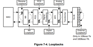

  • 1. Can you try forcing the speed on both PHYs to 1000Base? I'm wondering whether the RGMII-Copper PHY is negotiating a lower speed and there is a data rate mis-match between the two.
    2. If that doesn't work you can try looping the RGMII data back through the RGMII-Copper PHY and see whether you receive packets back from the PC point of view. If this works it would validate the RGMII interface is working correctly:
    3. If neither of these suggestions work, you should measure the timings and signal quality on the RGMII interface for both PHYs. The soldered jumper wires could be adding signal reflections or trace length imbalances that are affecting data transmission between the two PHYs.
    Shane
  • 1. Can you guide me with this? Currently, Pin 47 is set to Low (LED0 - Fiber Auto-negotiation ON). Do you want me to make the pin 47 high (LED0 - Fiber Force mode) for the EVM1 (Fiber-RGMII) board only? If yes, I did, and there was no luck.
    2. The setup was ready as per the above screenshot, but it didn't work. Do I need to change register and DPswitch positions to do a loopback test?

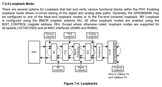

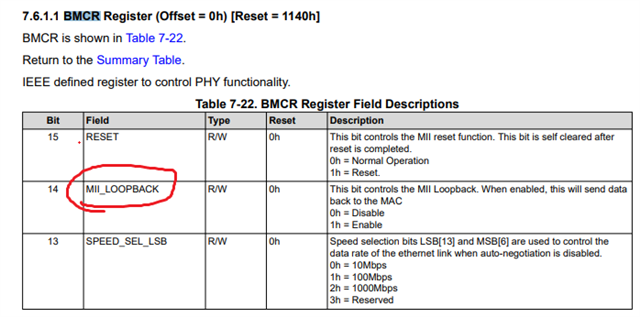

  • 1. Yes you should force the Fiber-RGMII PHY to 1000Mbps using the force fiber mode. At the same time, force the RGMII-Copper PHY to 1000Mbps by disabling auto negotiation and setting bits 6 and 13 to 1000Mbps mode in the BMCR register (0x0h)
    2. Yes, to perform a RGMII loopback test you need to set but 14 in the BMCR register:
    You can enable this on the RGMII-Copper PHY and send data from your PC. Ideally, the data will pass from PC -> UMC...-> EVM1 -> EVM2 (RGMII loopback) -> EVM1 -> UMC... -> PC. If you see the same data coming back on the PC that you are sending out, then the RGMII interface should be functional.
    Shane

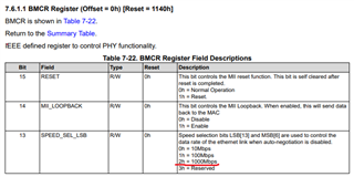

  • 1. Force fiber looks good, for the RGMII-Copper, set register 0x0000 to the value 0x0140. This will force the RGMII-Copper PHY into 1000Mbps mode.
    2. For loopback, you should set register 0x0000 to the value 0x4140. This is the same as the previous write, but with bit 14 set to enable MII loopback mode.
    Shane

  • 1. Can you check that the host supports 1000Mbps ethernet? Since we're forcing EVM2 to 1000Mbps speeds, the connected link partner also needs to support this speed or a link will not be established.
    on EVM2, when the copper link is established generally, both lights on RJ45 connector turns on and blinks, but none of them are turned on.
    Do you ever see the link established in bit 2 of register 0x0001 on EVM2? From your observation (0x0001 = 7949) it sounds like the link is not established here.
    2. Glad to hear the loopback test is working. Are you checking the received data for errors? If you're getting good data back on the PC, and can verify this is the same data that was sent from the PC, then the RGMII interface should be working correctly.
    Shane

    1. How are you putting EVM2 into this mode? It sounds like the link is established when you do this (0x0001 = 796D).
    • Are you able to ping the host when using this mode?
    2. It sounds like the RGMII interface is working correctly. If you still cannot ping the host, we can try running a digital loopback test on EVM2. To do this, make the following writes:

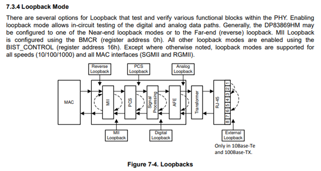

    • Write 0x0140 to register 0x0000 // Force 1000mbps
    • Write 0x0004 to register 0x0016 // enables Digital loopback
    Digital loopback would take the data stream deeper into the PHY before looping back towards the RGMII interface. The MII loopback we did earlier is a relatively shallow loopback that doesn't go into the PCS or processing blocks of the PHY.
    If the digital loopback is a success, it suggests the issue is in the connection between EVM2 and the host device used.
    Shane

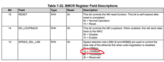

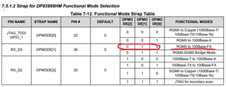

    Can you send me the values for the specific register to set it to 100 Mbps? I will attempt to perform both cases.
  • Can you send me the values for the specific register to set it to 100 Mbps? I will attempt to perform both cases.
    To force 100Mbps on EVM2, write 0x2100 to register 0x0000.
    For EVM1, force RGMII to 100Base-FX using the OPMODE straps shown:
    It seems like the 1G link is good when EVM2 uses auto negotiation. The digital loopback test failing is concerning, though the MII loopback is also failing now. This suggests an issue with the RGMII interface. Did something happen to the connection between the last MII loopback and this one?
    Shane
  • Hi Shane,
    After setting both boards to 100 Mbps:
    EVM1 (Fiber-RGMII) - Made pin 36 High - OP_MD_[1] strapped
    None of the LEDs have turned on, not even LED0—tested on both auto and forced. I have re-checked the physical connections; there was nothing wrong; it's just that the board wasn't able to detect it.
    EVM2 (rgmii-cu): When set, only LED0 turned on.
    After performing the loopback test, nothing came back. It failed.
  • Its strange that EVM1 cannot establish a link. Are you certain the link partner supports 100Base-FX or does it only support 1000Base-X?
    EVM2 seems to link up ok based on LED_0 turning on.
    Shane
