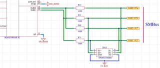

Hello Texas Instruments Team, can you please tell me if it
is possible to protect SMBus lines using TPD4E1U06DBV like this?
Yes, you can implement TPD4E1U06 like this for SMBus applications.
