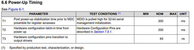

  • Hi Asano-san,
    Could you verify that the PHY is powered on and registers are accessed according to the following recommendation in the datasheet?
    Could you also verify that MDIO/MDC interface is sending data according to the following recommendation in the datasheet?
    If both specifications are within the recommendation, could you add delay function each register read/write access and run the entire script to see if all register values are initialized as it was intended to?

  • Hi J-san,
    This is Asano typing.
    Thank you for your response every time.
    As you pointed out, we will check the timing during power-up and MDIO communication through waveform measurement.
    After that, depending on the result, we also trial inserting delay function for each Read/Write access.

    No, this is not the expected behavior and should be set by single access. Could you check if the MDIO line has pull up resistor between 1.5k and 2.2k ohm, and ensure that MAC does not send out MDC signal over 25 MHz. In addition, please ensure that MDIO write command follows the following:
    Please let me know how this goes.
    J
  • Dear J-san,
    Thank you for your kind suggestion to improve the problem.
    Since your reply, we have investigated output waveforms by the surrounding circuit blocks
    and found that hardware (FPGA) design (inc. understanding of GMAC IP) that controls MDIO access was incorrectly designed,
    so as to fail to manage MDIO communication completion detection (it was not detecting completion correctly)
    Therefore, we have corrected the design to correctly detect completion of MDIO communication before proceeding to the next instruction.
    The situation has been resolved (without inserting a delay function).
