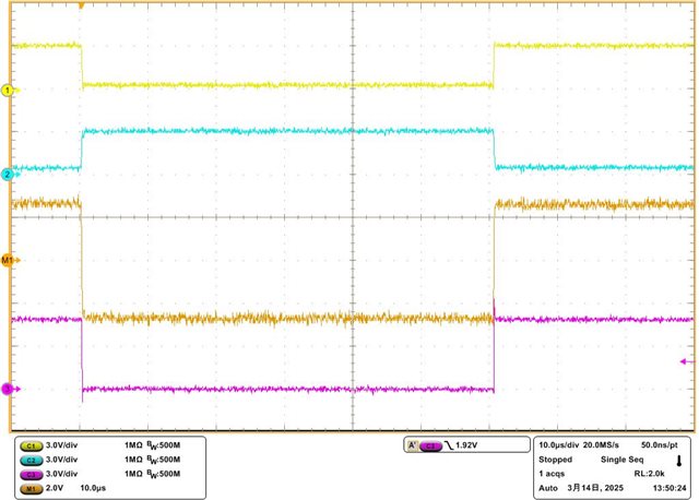

    I have attached a reference waveform.
    I have attached the waveform.
    CH1: Input 2A (+)
    CH2: Input 2B (-)
    CH3: Output
    Thank you in advance.

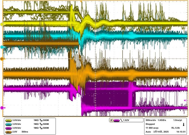

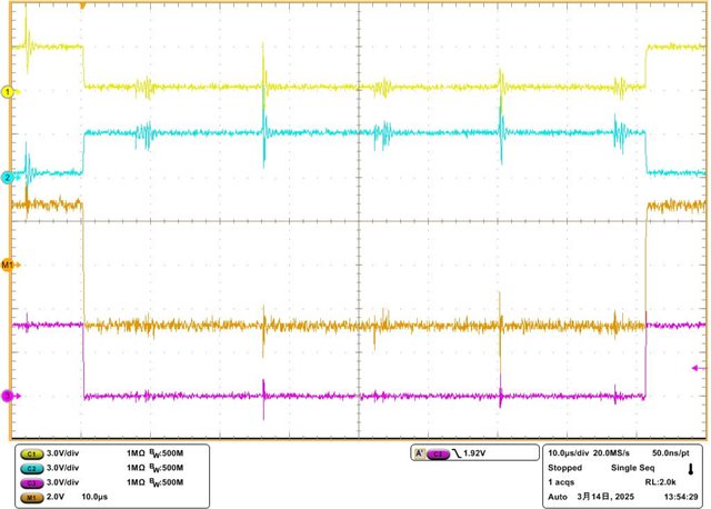

    I am attaching the waveforms that we are currently verifying in-house.
    ■Measurement points
    CH1: 1B (Receiver input +)
    CH2: 2B (Receiver output -)
    CH3: ENC_B (Receiver output)
    M1: CH1-CH2 (Differential calculation result)
    ■Measurement waveform
    91 Servo ON at amplifier ④
    92 Servo OFF at amplifier ④
    93 Servo ON at amplifier ①
    94 Servo ON at amplifier ④ (overwriting)
    95 Servo ON at amplifier ① (overwriting)
    *Amplifier ① is a normal device
    *Amplifier ④ is a B-phase abnormal device
    No.91
    No.92
    No.93
    No.94
    No.95
  • Dear BOBBY,
    sSorry, the text may not be displayed properly,
    so I will explain the following points again.
    ■Measured waveform
    91 Servo ON at amplifier No. 2
    92 Servo OFF at amplifier No. 2
    93 Servo ON at amplifier No. 1
    94 Servo ON at amplifier No. 2 (overlapping)
    95 Servo ON at amplifier No. 1 (overlapping)
    *Amplifier No. 1 is a normal device
    *Amplifier No. 2 is a B-phase abnormal device
  • No.91
    None of these signals look like they are going outside of the abs max.
    A-B looks relatively clean. I do find it strange that the CH3 is toggling. I'm wondering if the R output is probed at the wrong channel. Since A-B is negative we expect R to be a logic low for the entire duration of the signal.
    No.92
    This looks good, exactly what I would expect.
    No.92
    No issue with this one as well.
    No.93
    More noise but overall looks okay since A-B doesn't see much of it and R output remains stable.
    No.94
    This one, you may wanna double check the max/min values you see on the A/B pins to see if they exceed the abs max. I don't necessarily see it but with it zoomed out we may not catch it.
    No.95
    94 vs 95, there seems like a lot more distortion/noise is appearing. Is 94 the confirmed broken unit?
    -Bobby

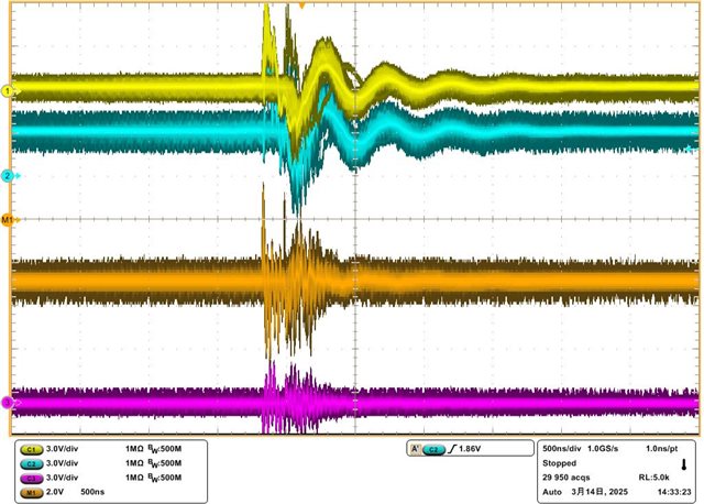

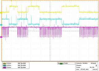

  • Dear BOBBY,
    Thank you for checking the waveforms.
    These waveforms were taken in our development lab.
    They are not from the user's equipment environment where the problem is occurring.
    Even if it were possible to take them, it would be impossible because there are no probe points due to the cable and equipment structure.
    No. 94 is the waveform of a broken unit.
    CH.3 output returns to its original state immediately after switching (failure mode).
    Is it the absolute maximum rating of the receiver IC after all?
    It will take a while, but I will try to take a waveform again using the absolute maximum rating as a trigger.
    These noise disturbances are waveforms affected by the motor PWM signal after the motor control servo is turned on.
    Looking at No. 94 and No. 95 (motor control servo ON), the PEEK appears to be about +/-6V at the moment it is affected by the noise.
    However, the PEEK appears to be for a very short period of time (about 20ns to 30ns?).
    Even so, is there a good chance that the receiver IC will be damaged?
    I will try to collect the waveform again using the absolute maximum rating as a trigger.
    I am currently re-running various noise tests at the same time.

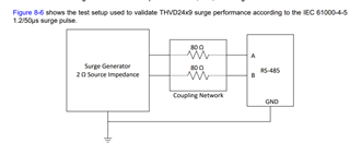

  • The output impedance of the signal source looks like it may be out of the surge spec if I recall correctly. I think the coupling element is supposed to be around 40 ohms (80 ohms in parallel with each other for a symmetrical set up).
    From the IEC standard:
    TI's set up for testing surge: (80//80= 40 ohms as per standard)
    What do R1 and R2 represent in the schematic? Is this the impedance of the external diodes?
