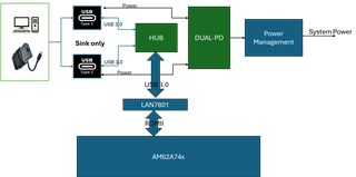

Hi TI team,
For my automotive application,
  • Two USB type-C for Sink only operation
  • User can connect any One of the Type-C to Host PC and another to Power adapter.
  • System should be powered by Adapter supply when connected or with Host supply (with downgraded power requirement)
I understand that I may require USB HUB and Dual-PD controller as shown in below high level diagram:
Please let me know the suitable design and HUB, PD for above application (preferably Automotive grade). Feel free to ask any clarity if required further.
