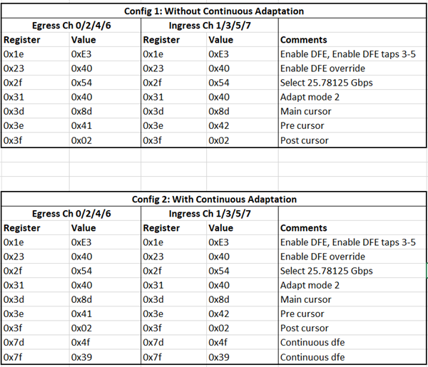

Please help to confirm the enable register is 0x7F or 0x23, and the 0x7F is the Continuous adaptive register?
Hi Zhang,
0x23/0x1E handle DFE enable.
0x7D/0x7F handle continuous adaptation.
I also noticed you are setting post cursor to +2. In most cases, customers set post cursor sign to "-" instead of "+". Have you tested these settings and confirmed they are optimal?
We will generate 2 EEPROMs according to the following configuration and share with you. The channel select register writes and cdr reset register writes will not apply for EEPROM.
I'd strongly encourage you to download SigCon Architect and install the DS280DF810 device profile so that you can generate EEPROMs in the future.
Drew

Customer feedback to us theb below:
1. They don't know how to set the DFE function and they need us to provide the open/ close the DFE EERPOM program;
2. They set the pose cursor to +2/-2 and the CPU RX eye pattern is well for +2 and substandard for -2 pose cursor;
3. They can't use the SigCon Architect and they have no USE2ANY tool so they need TI provide the suuport for this device, thanks.

Hi Zhang,
We made two EEPROM images according to the following configuration. Please find these attached.
https://e2e.ti.com/cfs-file/__key/communityserver-discussions-components-files/138/config1_2D00_modified.hex
https://e2e.ti.com/cfs-file/__key/communityserver-discussions-components-files/138/config2_2D00_modified.hex
