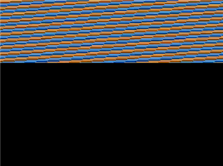

  • The image on the left is what we expect, and the image on the right is what we received. Although the image is not yet debayered, it is evident that we are not receiving the expected number of pixels.
  • In both cases, it appears that we are missing pixels and experiencing issues with horizontal and vertical syncs.

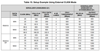

  • Hello Bram,
    In general, here is the table you should be following.
    Is the imager operating in CSI continuous clock mode? If so, then what is the frequency on the MIPI clock pins? And how many data lanes are active in the CSI port?
    If we know that, then we can calculate the minimum CLKIN frequency of the 935, in order to properly sample the incoming video data.
