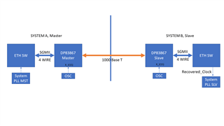

Can we do the clock recovery on the MAC side after SGMII on the Slave Ethernet switch? As per the above scheme
Based on assumption that DP83867,
will be transmitting SGMII data towards Eth Switch using MDI recovered clock when resolved as SLAVE during autoneg.
Similarly, when resolved as Master, MDI transmission will be done on the SGMII RX Data recovered clock.
