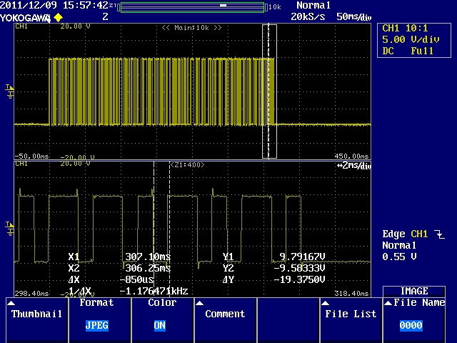

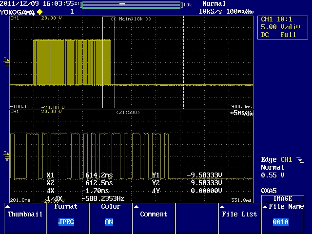

  • Hi Joe,
    I am attaching the scope capture while sending a 38-Byte data from HyperTerminal using Send Test File Option.
    I am also attaching the text file that is being used to send data from Hyper Terminal and the name of text file is 32Bytes.txt
    The last character that is in text file is 'J', however I see a hex value of 0xA5.
    1abcdefghijklmnopqrstuvwxyz2ABCDEFGHIJ
    The RS-232 pin is probed for two times. So, I have attached two JPEGS
    Please note that these captures are probed at RS-232 Level.
