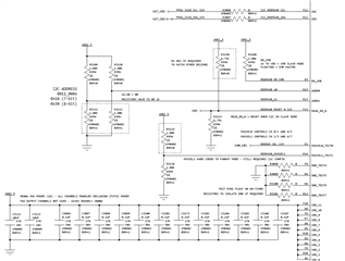

Our design uses two DS280MB810 devices with the need to use the MUXSEL pin control interface.

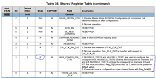

We are having difficulty enabling the pin control feature in SW.  We are able to successfully configure the MUX as desired using register 0x06, but we cannot enable pin control via register 0x05.
After reviewing the user guide and datasheet, it appears the MUX_CONFIG_PIN_CTRL register bit is READ ONLY?  We need to enable this feature, what steps are required to successfully configure this bit?
Does it require the use of an external EEPROM?  The datasheet and programming guide make no mention of such a limitation, there must be a method to enable this via I2C slave.
Chris
  • Schematic IO nets if interested - again, we are using I2C slave, there is no EEPROM connected, nor do we have the hooks to support one.
  • Hi Chris,
    Thanks for sharing details on this issue you're observing and for sharing your schematic.
    I have a couple thoughts on this issue:
    • MUX_CONFIG_PIN_CTRL is not read only, this is an error in our programming guide.  It is actually not possible to enable MUX pin control on this device with just EEPROM since this bit is not included in EEPROM (EEPROM = N).
    • From programming guide: "Note that shared register 0x05[1] of both quads must be set to 1 to enable pin-control crosspoint mode. Each quad can be selected through Reg_0xFF[5:4]"  Can you confirm that you're setting MUX_CONFIG_PIN_ CTRL = 1 in both quads?
    • Can you share your configuration sequence?
    Drew
