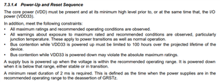

Additionally, please ensure the power-up timing requirement is being met:

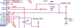

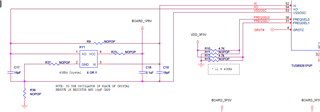

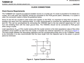

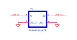

Is this a crystal or an oscillator? If this is a crystal, then VSSOSC should not be pulled down to the PCB ground, and should instead be left floating.

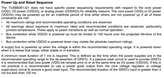

What is the sequencing for powering this device? Per the errata for this device, VDD(1.1V) needs to be powered before the VDD33 rail, or else there will be issues in the power-up sequence.

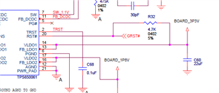

For the GRSTZ pin, in our EVM, we have this pulled down to ground via a 220nF capacitor in order to delay the pin asserting, per the datasheet:
I see it only pulled-up here with no capacitor, that may be affecting it as well I believe.
I will keep looking to see if I see any other potential causes.
Ryan
Hi Ryan,
There is no activity on USB lines, since connection isn't established. Following changes are done,
1. VSSOSC made to float & made sure 1.1V is powered ON before 3.3V suuply.
2. 22uF capacitor added at reset section. But link up isn't happening.

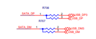

I was looking back through the schematic, and noticed that it looks like the USB2 DP/DM lines split between three different locations, the AM572x, the Micro-b connector, and the TUSB9261. Are these lines all connected together at the same time? splitting the USB2 lines can cause issues with signal integrity, or if there is activity on the lines from two different devices at the same time, I.E The AM part and the TUSB9261 going to that micro-b connector, that could potentially cause issues as well. Please confirm how all these are communicating via USB2, a block diagram may help.
You mentioned removing a FB on the Micro-b helped show the device appear on device manager. I see multiple FB's on these schematics, could you try removing those to ensure they are not harming the power supplies/rails performance?

DP/DM lines are connected between TUSB9261 & USB Connector. Even, I suspected the FBs, I removed all & tried to provide required voltage from external source.
On the schematic, specifically the picture above, it looks like the USB2 signal is broken out. Are one of these resistors depop-ed so that there is only a connection between the connector and the TUSB9261?

At a time, either 1-2 are populated or 1-3 are populated.

I took a look a little more at your schematic, and I noticed that there are no load capacitors on your crystal, as per what is recommended on the data sheet and EVM:
This may be affecting the reference clock for this device, which could in turn affect the overall performance of the TUSB9261. If possible, I would recommend adjusting your board to mirror this implementation.
Additionally, I did notice that the GRST pin on our EVM also has a capacitor connected to ground, which would help delay the start-up of this device and allow VDD to ramp up. Maybe that could be implemented to see if that improves performance:
Ryan
Hi Ryan,
I have provided reference clock externally using function generator & also added caps at reset pin.

Just to confirm, the clock you generated was 40MHz and going into the XI pin, and you left XO floating and VSSOSC pulled down to PCB ground, correct?

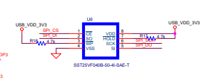

Another thing you could also test is removing R710 and R711, which connecting to the SPI_DATA_IN/OUT lanes. By removing these, it should disconnect the EEPROM, and we can see if the TUSB9261 embedded memory/boot loader is able to enumerate correctly.
Ryan
Hi Ryan,
Yes, while providing 40MHz clock externally, I made XO pin to float & pulled VSSOSC to ground.
Now, I'll check removing the SPI Lines of EEPROM.
Jayanthan V
Hi Jayanthan,
Okay, thanks for confirming. Please let me know what you see when you remove the SPI lines.
Ryan
Hi Ryan,
Thanks, TUSB9261 is deducted after removing R710,R711. But I'm unable load the ti hex file file using TUSB Burner.

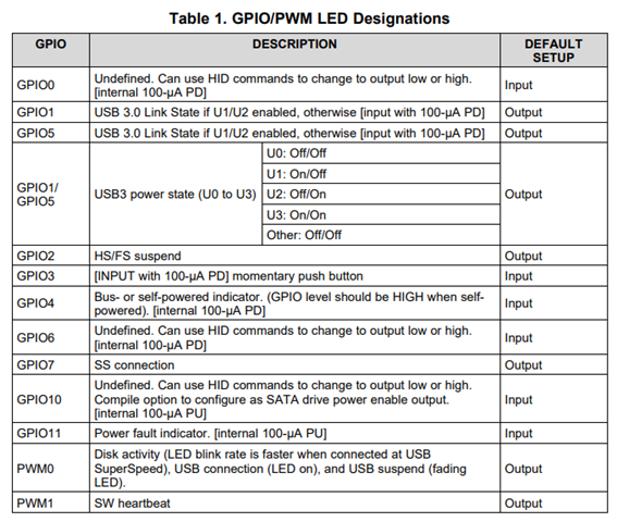

What HEX/BIN are you using to flash the TUSB9261? The firmware that is provided on TI.com? On the TUSB926X flash burner, how does the TUSB9261 appear on there? How does the TUSB9261 appear on TreeView, I.E PID/VID, data speed.
Is there any activity on PWM0 or PWM1?

It is working now. R710 need to be removed initially, board was turned on, TUSB was detected in PC, at this time, we shorted R710 manually & dumped the code. after that power was disconnected, 0 ohms assembled at R710 & when board turned ON , TUSB firmware runs from EEPROM.
