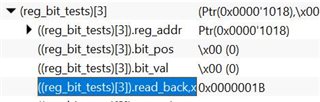

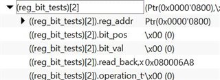

    We are using TCAN4550-Q1 with AutoSAR MCAL. We switched the CAN transceiver and controller states according to the demo program. The transceiver's initial state was configured to standby mode. We called the API CanTrcv_44_TCAN4x5x_SetOpMode to switch the state to CANTRCV_TRCVMODE_NORMAL, and then called the API Can_44_TCAN4x5x_SetControllerMode to switch the controller state to CAN_T_START. However, the call failed. The function that failed was Can_44_TCAN4x5x_MCAN_ResetInit. Upon checking the CCCR register, we found that an attempt was made to write 0x18, but the read value was 0x19.
    Transceiver initial state as standby mode 0x0800 register value:
    Switching the transceiver state to normal mode 0x0800 register value:
    Initial state CCCR register value:
    Try to write 0x18:
    Read value:
    So, if we want to use the MCAL plugin based on AUTOSAR that you provided, are the above steps correct, and are there any other options that need to be configured?
    Thanks!
    Zhengchao

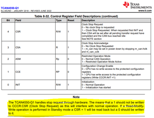

  • Hi Zhengchao,
    I don't have any additional information about the MCAL driver than what is provided with it.  However I did have one concern with the following step:
    Try to write 0x18:
    The datasheet states that a "1" should not be written to the Clock Stop Request (CSR) bit 4 of the CCCR register.  If they are writing a value of 0x00000018 to the CCCR register 0x1018, then they are doing this which will halt the MCAN controller and will cause the INIT bit 0 to be set to 1 as well.  This bit will read back 1, but should always be 0 in all writes.

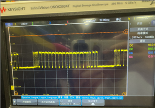

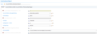

  • Hello Jonathan,

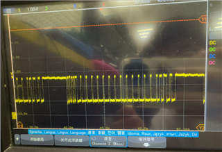

    We used an oscilloscope to measure CAN_H and CAN_L, and the signals from the TCAN4550 are as follows:

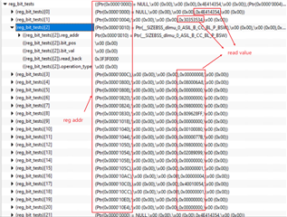

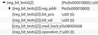

    However, I did not receive any information using CANoe. Therefore, I would like you to confirm if there is an issue with the register values. The register information read is as follows (only some registers):

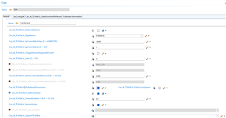

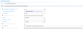

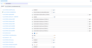

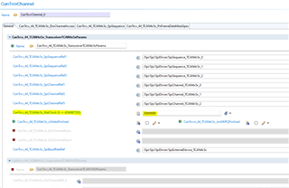

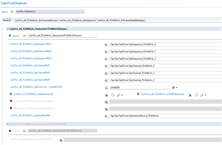

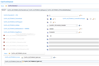

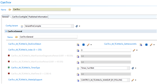

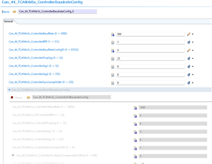

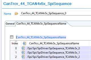

    Additionally, we are using the EB tresos plugin provided by you. I would like you to check the configuration information to see if there is any issue with my configuration:
    1 CAN controller:
    2 CAN Trcv:
    Many thanks!
    Zhengchao
  • Hi Zhengchao,
    I apologize for the delay.  Thank you for your patience while I was out of the office last week.

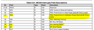

    The MCAN Interrupt Register has bits 27, 24, and 23 set which are for PEA (Protocol Error in the Arbitration Phase, Nominal Bit Time is used), EW (Error Warning Status, and EP, Error Passive.  This indicates a likely issue with the bit timing or clock that is resulting in an incorrect bit timing configuration causing the CAN messages to generate errors with other devices that are configured correctly.

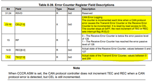

    The Error Counter Register (0x1040) does also show CEL and TEC errors are being accumulated.
    The Modes of Operation and Pin Configuration register 0x0800 has the CLK_REF bit set to 1 (bit 27) which tells the device the crystal frequency is 40MHz,  but your configuration seems to indicate a crystal frequency of 20Mhz.
    You didn't provide the actual Nominal Bit Timing and Prescaler register (0x101C) value, but your time quanta configuration appears correct for 500kbps when using a 20MHz crystal.
    Verify the value of register 0x101C matches your desired configuration.  Also measure the bit period on a scope to make sure it has the correct width for a 500kbps bit which should be 2us.
    The TX Buffer Configuration Register (0x10CC) does show there is a TX message pending transmission that has not been successful, so this indicates a likely bit timing configuration preventing any other CAN nodes such as the CANoe from recognizing the bit timing as correct.  This would explain the bit errors, the lack of acknowledgement, and the TX message pending status.
    Verify the bit timing is compatible with both the TCAN4550-Q1 and the CANoe configurations and try again.
