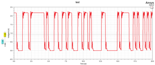

I'm currently working on a CAN bus simulation and have observed some glitches on the differential signal (CANH - CANL).
The threshold present on this curve is VT+(max) and VIT-(min).
ZOOM :
Could these glitches cause any issues in the integrity of the CAN bus?
Thanks in advance for your help!
  • Hi Pierre,
    Yes, as it seems the glitch is near thresholds and can be misinterpreted.
    I would recommend to investigate the source if due to signal integrity issues, network configuration or external interference, improper termination, grounding issues etc, thanks.
