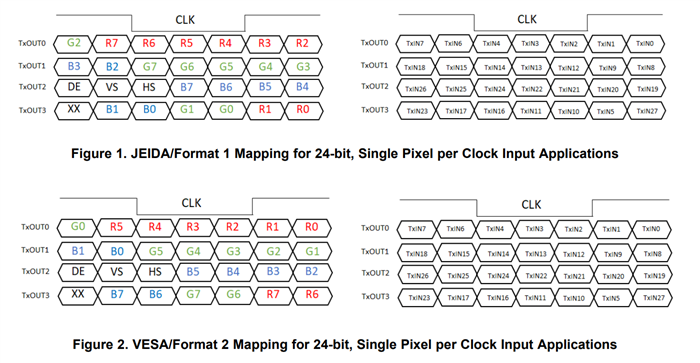

I have an NXP iMX9352 with integrated LVDS phy. The datasheet says it supports common display LVDS receivers which I assume are 24 bit VESA or JEIDA mapping.
I am using the DS90CR286A to deserialize and the TFP410 to finally output TMDS lanes.
If the LVDS output already complies to a standard, and the TFP410 is my "RGB Receiver" then
Do I connect RX0-23 VSYC, HSYNC, and DE up to TFP410 input 0-26. in a 1:1 straight connection leaving RXout27 disconnected
OR
Do I need to connect RXout 27 to TFP410 input 23 to get R0/R6 bit, and leave RXout23 disconnected
The DS90CR286A is confusing me with the color mapping calling RXout23 as the general purpose bit.
Is the mapping already taken care of in the host processor output, or do I need to take care of it in Hardware traces between the deserializer and TFP410?
The app note for LVDS to HDMI is too vague.

    TxIN23/RxOUT23 is called the general purpose bit but for most cases it is not used since 24-bit RGB video contains total 27 bits (24-bit video + 3 sync signals) and the LVDS frame has 28 slots for data.
    For LSBs on RxIN3 (JEIDA), RxOUT27 will be connected to TFP410 input 16. For MSBs on RxIN3 (VESA), RxOUT27 will be connected to TFP410 input 22. You can leave RxOUT23 disconnected if you prefer.
    The TFP410 expects the following input for R, G, and B components
    You will need to take care of the traces between the CR286 and the TFP410 depending on the LVDS mapping scheme. If the mapping scheme is incorrect it will result in incorrect colors received on the display.

    So if my LVDS phy already complies with the VESA standard, and I then reMAP with connections in Hardware, will it undo the mapping.
    I think you answered the question though, no matter what the TFP410 is expecting RED(7:0) on 23:16 etc... So I have to remap everything in the CMOS traces on the board.

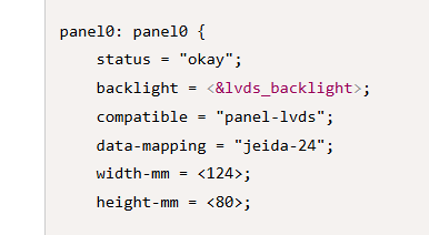

    (Unless there is a way to pre-map the LVDS video controller and phy output... but this is a provided linux driver and not sure I want to write my own driver for this)
    From a quick search, I found a thread on the NXP forums where there is an option for data format. I'm not an i.MX93 expert so double check the available documentation for your processor, kernel, driver, etc. I haven't seen an LVDS TX that only supports one data format.

  • Thanks, I didn't dig into the forums...
    That gives me a place to search.
    The NXP data sheet is very specific on what it supports <more sarcasm>
    So, it isn't VESA or JEIDA, it only supports "relevant" devices. :-)
