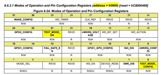

The TCAN4550 is put into test mode using TCAN4x5x_Device_EnableTestMode(TCAN4x5x_DEVICE_TEST_MODE_CONTROLLER), and ensuring that the function returns true.

    The TCAN4550 is a combination of the MCAN CAN FD Controller and a CAN transceiver.  System level compliance tests have MCAN specific tests, and Transceiver specific tests and so there is a Test Mode that allows the TX and TX signal to be accessed through the GPIO1 and GPO2 pins. What can also be confusing is that the MCAN controller also has some "test mode" capabilities in the form of loopback testing that does not require the device level test mode functions that re-route out the internal RX and TX signals to the GPIO pins.
    The TCAN4x5x_Device_EnableTestMode(TCAN4x5x_DEVICE_TEST_MODE_CONTROLLER) function will disconnect the MCAN controller from the transceiver and will be using the controller test mode as shown in figure 8-11 in the following figure.  The two test modes grouped by the red line allow the MCAN and transceiver test modes.  Neither figure 8-10 or 8-11 that are enabled with this function are what you want for doing a loopback test.  Instead, I do not think you  want to use this TCAN4x5x_Device_EnableTestMode  function and instead just configure the appropriate MCAN registers.

    The TCAN4x5x_Device_EnableTestMode function is controlling bits in Register 0x0800 which is a non-MCAN register related to routing our the internal RX and TX signals.
